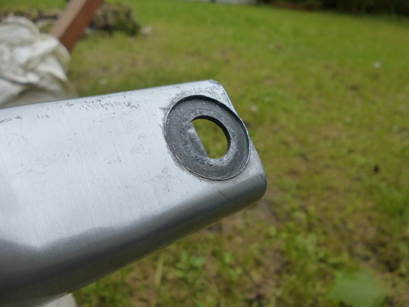

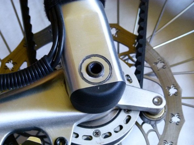

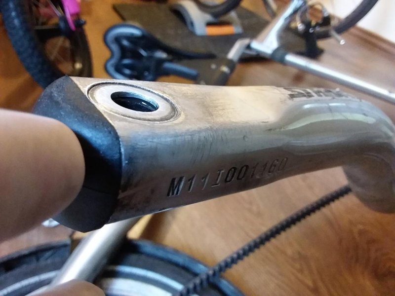

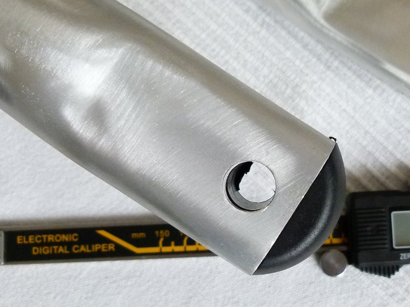

I beg for your understanding that it may not work on frame tubes like this:
Chances are much better here:
Or here, this is less (!) wear:
New tube for comparison:
