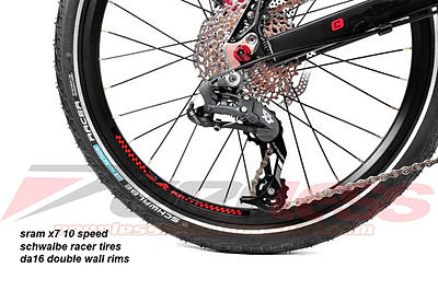

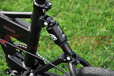

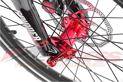

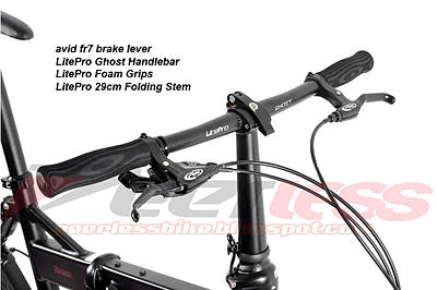

Le CRUS, déjà signalé sur le fil du Rhine :
Une copie quasi-conforme de Jetstream, entre P8 et XP/EX.
Comptez 750 EUR hors frais de port et frais de Douanes (source : membre Heisenberg)
Specifications :
- ALL TERRAIN 20-inch suspension frame
- LitePro ghost 2014 aluminum alloy straight to
- Avid bb5 disc brakes
- Split 20 inch spinner air pressure fork can be locked
- Kore 33.9mm seatpost monorail
- LitePro 53t full cnc crankset (with support the market)
- SRAM x7 10s medium cage rear derailleur
- SRAM x7 10s single right thumbwheel
- SRAM pg1050 11-32t freewheel Mountain
- Schwalbe Marathon 20x1.5 foldable tires and tubes
- LitePro m228 pedals
- KMC X10 10-speed chain
- kindshock air 150mm Shock Absorbers
- avid fr7 brake lever
- DA16 406 disc wheels (100/135 red axis black bar black circle)
- 44mm special built-in headset
http://peerlessbikes.wix.com/peerless#! ... lding-bike
