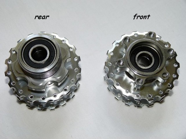

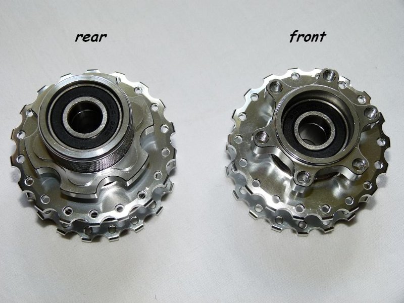

Bonjour
savez vous si les roues strida avant et arriere sont identiques?
on me propose deux roues avant et j'aimerai changer les deux roues

No, the hubs are different. (18" Strida hubs)

merci pour la reponse

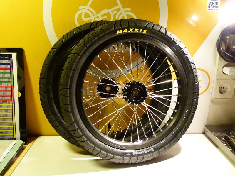

Hint 2:
Strida 16" wheels have 24 spokes.
Strida 18" wheels have 36 spokes!
50% more spokes -> more stability.
Hint 3:
Still problems?
Consider custom wheels, use 18" hubs and 16" (but 36H, non Strida) rims.
Result -> "bombproof" 16" wheel with 36 spokes.
I say: It can be so easy.

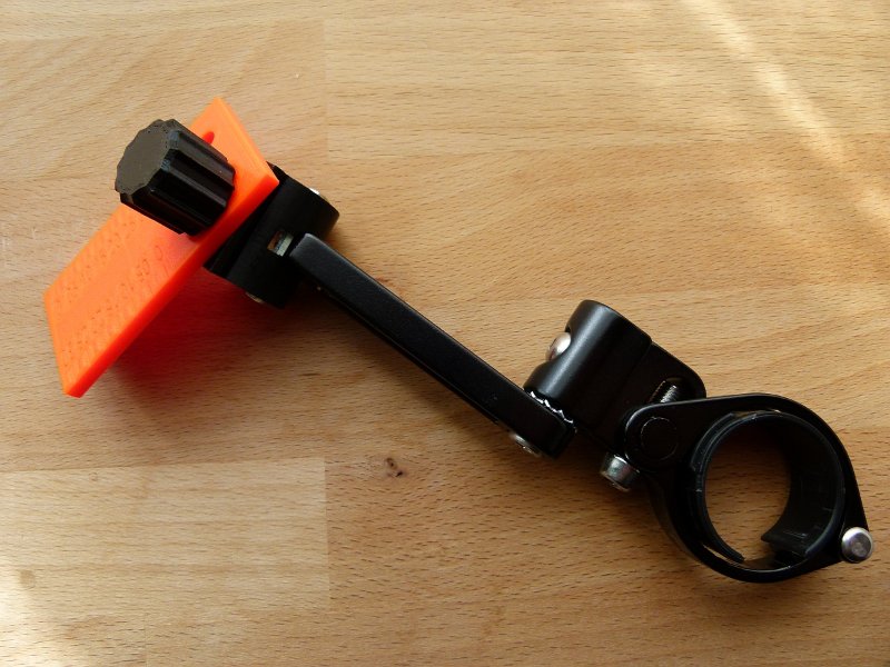

Just a Minoura swing grip and three simple 3d printed parts.
Not a trueing stand, but useful trueing device.
Rip off the tyre, clamp it on the frame, adjust and start trueing (+ use chalk method).
Works, no trueing stand required.

Hint 2:
Hint 3:
Still problems?
