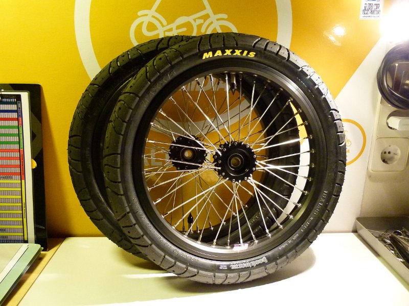

your question implicates somehow that you can't believe that - we did not believe that either, back then.
But we tried already - please feel free to try yourself, too.
Btw, we tried also the Hutchinson Greenville 16 x 1,75" (47 - 305) which should fit in theory - in practice it does not.
On a Strida, the wider tyres you want - the more you need metal spoked (or even custom) wheels.
Metal 16" Strida wheels will accept Schwalbe Big Apple in 2,0" width - but only these and no others!
You will certainly get mad while trying to mount, for example, Maxxis Hookworms - even if these are less wide than Big Apples.
Is that weird? Sure!
Is that Strida? Yes, sure!
That overkill of weirdness below (2,3" width!) is possible as you can see - but with non-Strida, extra wide BMX rims solely!
The economical alternative are 16" Strida metal spoked wheels plus Schwalbe Big Apple in ETRTO 50 - 305 in my opinion.
Hint; don't overlook that you also have to modify the magnet connection somehow (Spacers and longer bolts required.)

Strida 16" plastic wheels:
Strida 16" metal spoked wheel (24 spokes):
Strida 18" wheel (36 spokes):
Custom wheels, composed of black anodized 18" Strida hubs, Sapim Leader spokes and riveted 16" BMX rims:
